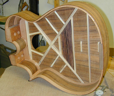

I've been asked to build a 6/12 acoustic doubleneck.
Anyone ever done this or know where I could lay my paws on a pic of a bracing pattern other than the Ovation, cos I don't have a spare plastic bath to use as a back.........
Thanks in advance!!martinedwards38913.2162731482
PostPosted: Sat Jul 15, 2006 12:04 am
Been there done that ... here is mine, the X has 20 thou CF laminated in it, the bridge patch is likely a tad heavy at 3/16. I believe the X is sized at 10x18mm. The top is koa obviously, and was about .130 thick. i f I had to do it again (and I ahve been asked by more than one), I would make the neck block(s) one piece - it makes for an easier bend between the necks, as this one is actually two piece, both bent at about 50-60 thou, then epoxied together. You are also seeing a fairly heavy upper transverse, this allowed me to use all bolt on necks (see the thread on neck setting, you can see a neck that I used to use in there, same as for this guitar) It had to be 1/2 inch thick to allow for the mortice and small bolt to go into the FB extensions

Thanks Tony, that looks great!!
How does having some strings not crossing the soundhole affect the sound? I was thinking about two soundholes with a "figure-of-eight" rosette, but a single would be easier.......
PostPosted: Sat Jul 15, 2006 2:17 pm
I dont know - should it make a difference ??? You are still exciting the top via string vibration - its not like the soundhole has to be under the strings.
